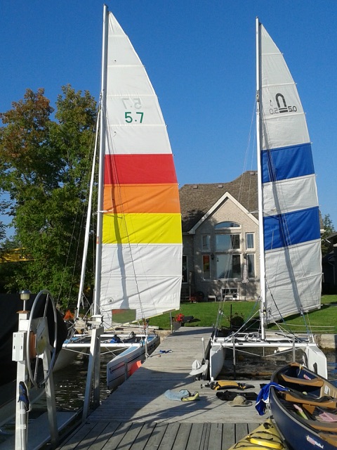

The Nacras are pretty slab sided on the inside, slightly bulging on the outside of the attachment straps. the H18 hulls bulge slightly inside & outside of where the beams meet the attachment tunnels.
Initial plan was to place the Dart where the Nacra 5.0 resides, (blue & white sail).
However, the Dart is to wide to fit between the uprights of that lift, & too narrow to span them as the Nacra does.

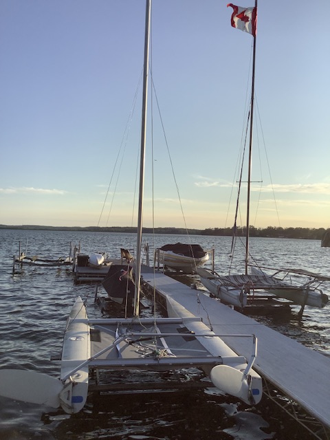

Thanks for that information. After looking at and rejecting a half dozen Sea-Doo lifts, I found quite an old one that was made back in the days when SeaDoo were quite small.
Had to put a new cable on it, but it gives me plenty of clearance for the posts to be inside the hulls of the Dart.
She set up and ready to go for the season.
