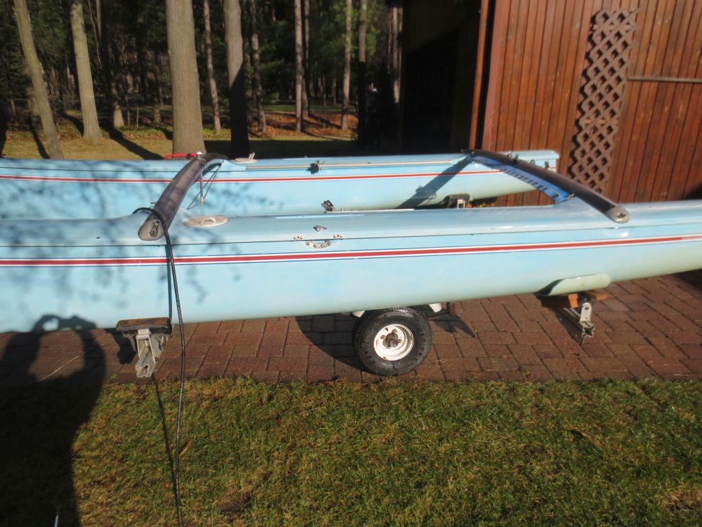

You can achieve a close enough measurement on skeg hulls by measuring across the top decks, from the centre of one hull to the centre of the other, as they are symmetrical.
I have two other skeg hull Cats, a Nacra 5.7, & a Nacra 5.0, & a "round hull" Hobie 18 Magnum,(wings), but only one Trailex aluminum trailer. All four boats vary in width.
I don't often move them past the back yard, but on occasion people have borrowed one, & it is a 5 minute job to move the rollers on one side by a few inches.

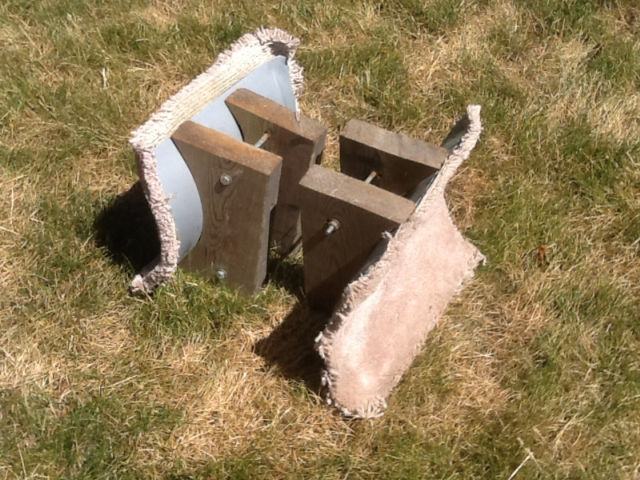

It may be blasphemy to mention other Cats in this forum, but, perhaps you occasionally have the need to move a different Cat? Say one with round hulls that need their weight distributed on more area than the rollers provide.
One trailer will accommodate many Cats with a simple jig, knocked together from a piece cut out of 10" diameter plastic sewer pipe, a few countersunk SS screws, & bits of 2x4 or 2x2. Attach the bits of lumber so the roller will just fit into the gap.
I use V bunks at the front, rollers at the rear. If you need to move a round hull cat, simply drop the jig over the rear rollers, then secure the Cat. This is how I move the H18
